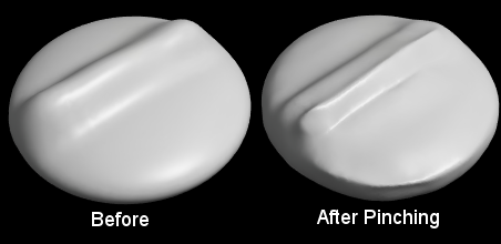

4.7. Pinch
Paint to Tighten and Shrink the surface along the stroke.
Pinch tool used on edges to sharpen them up

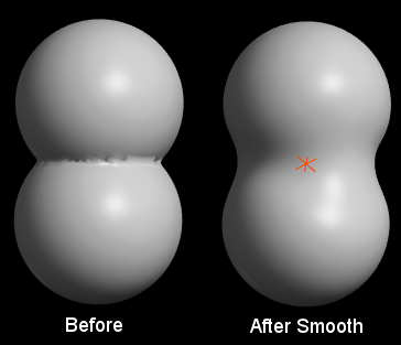

4.8. Smooth
Paint to smooth the surface. Elastic effect will tend to shrink the surface.

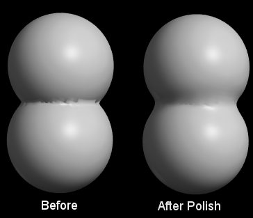

4.9. Polish
Paint to polish the surface. Improve surface curvature with little change to volume.
Polish has a more subtle effect than Smooth, fixing small defects while leaving the overall shape intact.

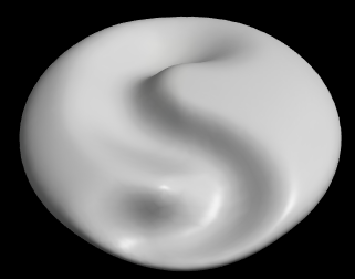

4.11. Flatten
Paint to flatten the surface.
Flattened Sphere
4.12. Flatten to View
Paint to flatten the surface towards the current viewport.
Flattened Sphere
