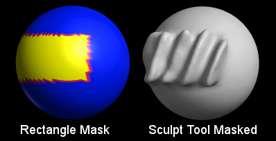

5.1. Mask Rect
Drag a Rectangle to Mask part of the mesh to edit.
Hold Shift to add to the current masked area.
Hold Ctrl to subtract from the current masked area.
Makes a sharp edge mask - you can use "Mask/Smooth" to soften the edge of the masked area.
Using Move Tool on Masked Region
Using Sculpt Tools on Masked Region

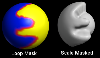

5.2. Mask Loop
Drag a Loop to Mask part of the mesh to edit.

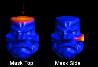

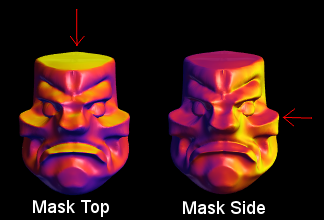

5.5. Mask Angle
Click to a select surface orientation, and Mask the mesh compared to that direction.
This is useful in tandem with the "Limit Mask" tool which clamps the mask to a tighter range.
With a Mask tool selected you can use the Right Mouse Button as a Shortcut to the Limit tool.

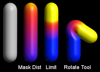

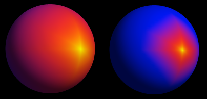

5.6. Mask Dist
Click to Mask mesh by distance to the clicked point.
It is also useful to select connected parts of a mesh when you want to avoid selecting other nearby parts.

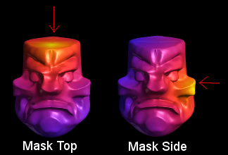

5.7. Mask AngleDist
Click to Mask nearby parts of a Mesh with a similar orientation.
This tool gives the tightest selection as it is controlled both by distance on the surface and surface angle.
It is handy for selecting flat planes in a model.

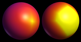

5.8. Mask Limit
Click to crop a smooth Mask to the clicked value. Useful for shrinking a Mask.
Using Limit to shrink a mask
You can achieve the opposite effect (enlarging the masked area) by first using "Mask/Invert", then using the Limit tool, then inverting back again.
Inverted Mask Limit
Using regular and inverted Limits together increases your mask's contrast and gives you exact control of the mask's falloff.
Using Limit to shape mask falloff for a bend
