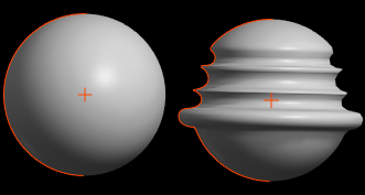

3.1. Add Curve
Draw another Curve to shape the current object.
This tool works with Lathe and Loft objects as they support multiple curves.
After drawing a new Lathe or Loft this tool is automatically selected ready to draw more curves.
Drawing a 2nd curve for a Lathe

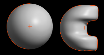

3.3. Draw Details
Redraw a small part of the Curve.
Replaces a short segment of the original curve with a new drawn curve.
Redrawing part of a curve

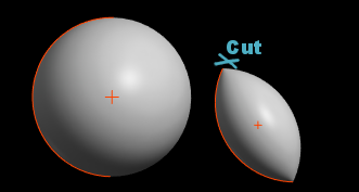

3.4. Trim Curve
Click on the Curve to Trim it to that length.
Trims the shorter side of the curve. If you need to trim over 50% of the length just cut several shorter segments (each shorter than 50% of the curve).

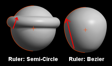

3.5. Straighten Curve Segment
Drag between two points on the Curve to straighten a segment.
Alternative Ruler Styles
You can use this tool with a number of different styles apart from Straight. In the Curve menu choose Ruler Mode... then pick a style. Each of these will automatically redraw a segment of your curve while trying to match the style shape.
In the case of Ruler Mode.../Smooth the segment of the curve is smoothed. This is useful for controlled smoothing of a short part of the curve.
Different Ruler modes for Straighten tool.
