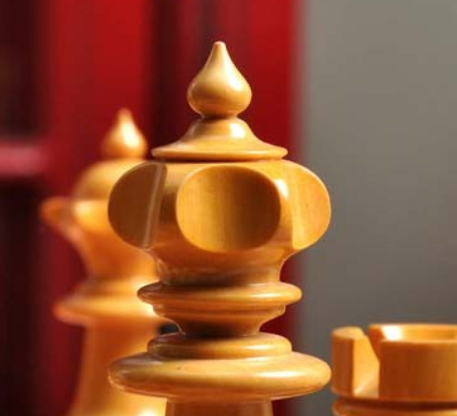

I'm attempting to recreate some chess pieces as a first project. Most of it's pretty straightforward with the lathe tools (which are incredible btw). I'm getting stuck trying to recreate the king's head as seen here:
Specifically, those concave grooves of the crown. Not quite sure how to accomplish that in Curvy, or if it's even possible (maybe use Blender for that, but figure I would ask first)

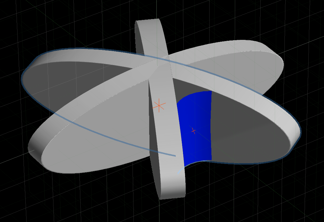

My efforts thus far look like this:
Basically, flattened cylinders rotated round one another to make the base; for the concave curve, I isolated part of a cylinder (deleting the rest via mesh select) and inverted it.

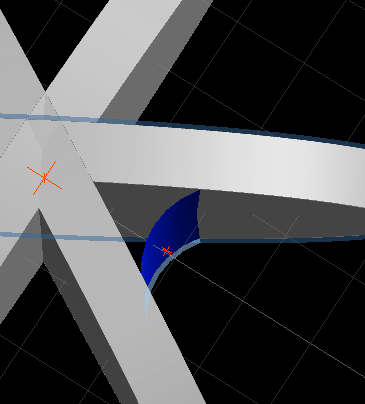

However this leaves me with a gap between the concave curve and the crown base, seen here:
I'm at a loss how to stitch that bit up. I was hoping that joining them together as a single object and using a command like 'stitch holes' might do the trick, but no dice. Would love to know how, or if there's a simpler/more elegant solution to tackling this kind of thing. This is the best I've gotten with random experimentation.

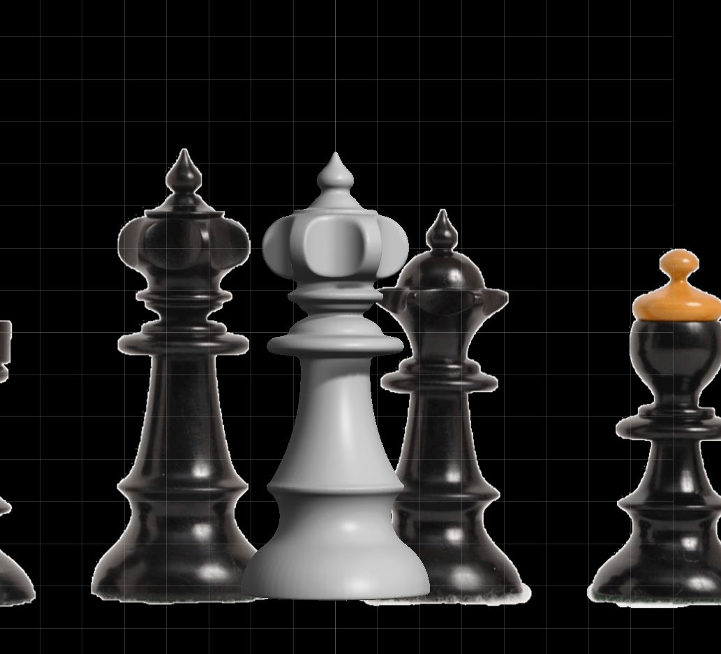

There are lots of ways to achieve this effect :) First off I'd ignore the dents and draw the full shape with a lathe. Then go back to add the dents.
There are 3+ ways to add a dent to en existing model. I'll mock one up...
This one uses "Mesh/Voxel Subtract Children"
Five cylinders are subtracted from a lathe in one go (I joined them and set them as a child of the lathe before using the command)
After making it I realised it would have been better if I'd made the dented section as small as possible, and left the parts above and below as simple lathes (You can make the Voxel settings use a higher resolution for a crisper edge, and you will probably have to smooth the subtracted dents to make them look the best)

Worked like a charm, thanks!
