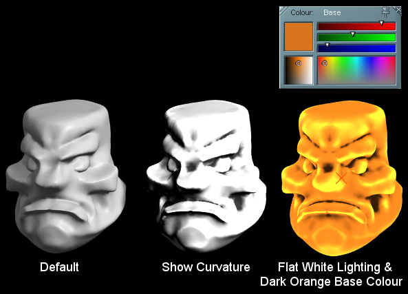

3.12. Show Curvature
For Adaptive Subdivision Meshes this option shades your model to exaggerate curvature.
When used on a default material it will appear over-exposed and too bright. To get the most from the curvature enhancement use a flat white base lightmap, and a dark orange base colour.

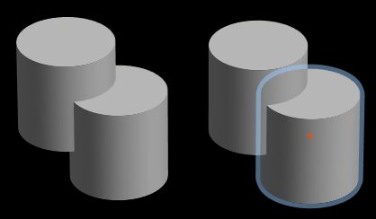

3.13. Outline Selected
Turn on to draw a thick outline around selected objects.
See below the outline is visible through other objects making it easier to locate objects in a busy scene.
