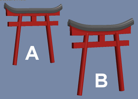

Here is a example gate you can load in Curvy to see how it was made.
http://www.curvy3d.com/models/gates.cvy
The main trick is making the roof out of a loft, with the first curve running the length, and the second curve drawing a cross section of the ^ shape.
Then add depth to the loft using the object properties slider.
To get a smooth, man-made look you will need to smarten up your original hand drawn curves. I tried this two ways...
A) I uses "Redraw As... Straight Line" to flatten it, then used the soft move tool with a spike shape to lift the tips of the curve.
B) I used "Redraw As...Ellipse Arc" to make a long sweeping curve, then used the Ruler tool to flatten the bottom of the curve. And finally used smooth (S) to soften the join between the curved and straight parts of the shape.
To further flare out the tips of the roof you could convert to mesh and use the soft move again, pulling out sideways.
