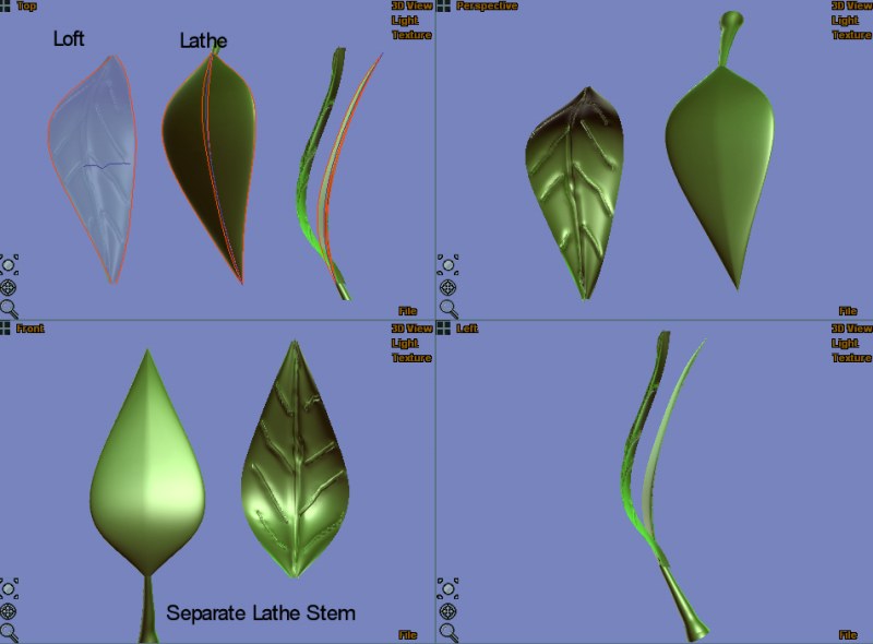

That is a good shape you've got there. I would use separate lathes for the leaf and the stem, and perhaps model one side of the leaf individually and use Mirror to make the other side. (You can always merge the stem later)
Here are two examples, one uses a Loft with an M-shape path to add a bump in the middle of the leaf. The other is a simple 4 line Lathe with smooth curved sides. The stem is a separate object.
Here is my cvy file
http://www.curvy3d.com/images/leaf.cvy
If the leaf is going to appear in the background you could also use a rectangular loft and add an image texture with an alpha channel to cut out the shape of a real leaf.
