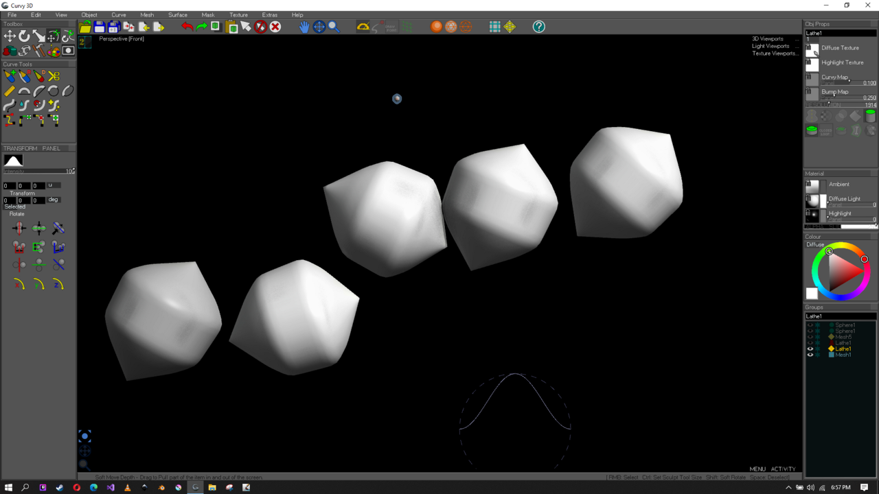

Hey,
I have version 5.01 so some things may not work the way they work on your program. The scale of the mesh when stroked is way different than the original mesh. Also, restroke doesn't seem to work for this. How do I stroke onto meshes?
THanks!
Wes
Re: 3D Brush Strokes
Brush Strokes uses the radius of the curve for the item size (like a Curvy Line Object) So you can alter the size and number interactively.
At the moment you draw onto Frozen meshes. The little Snowflake on the groups panel to freeze an object.
