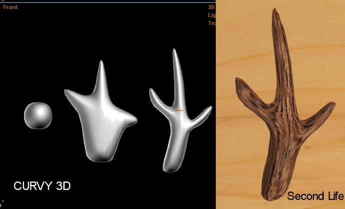

I began with a round Lathe, and set the resolution slider to 2000 before converting to a mesh (press 'K' making sure to be in Sculptie Mode)
Then you can see a similar level of detail to in SL while you sculpt and carefully balance out the areas that recieve more or less polygons.
I pulled out the branch from the top win Widget move tool set to 50% radius, and from the sides with 30% radius. I pulled from the bottom using a square shaped widget tool (drag on the shape in the widget properties panel to change the effect shape). Then use Smooth (press S) to clean up any jaggies. You could also use the warp smooth brush for more control of this process.
See the result uploaded to SL below:
The problem you go with your example is that Merge changes the UVs so they are no longer sculptie-ready. There are ways around this by Inflating a sculptie-ready shape to fit your merged shape - there is a tutorial for that here.
To avoid stretching the texture I recommend you use a high-res texture and paint it for the object in Curvy - that way you can scale the details to appear unstretched - even though in the 2D texture map they will look scrunched up.
sl model untextured
curvy pic bottom left corner
sorry hadn't realized sl target wanted :)
put curvy in sculptie mode
draw a very simple pole using a lathe
set resolution 2000
convert to a mesh with k key
then pull out branches using widgit move tool
p.s. this model took about 30 seconds (just to demonstrate )

Ok Great! Thanks so much for the help Simon and Sculptor. I'm getting somwhere now by using the widget move. So nice that the size and shape of that tool can be changed as needed. Here is what I got:
On the inworld model I decreased it length on the Z axis a bit.
