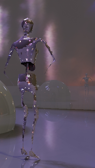

created in curvy
Trying out my new Bryce 6.3 renderer
It was extremely difficult to work out how to use the HDRI
it wasn't until I deconstructed one of the bryce example scenes that I clicked on

Was this made with a single HDRI lightsource? I like the way the shadows are different colours in different parts of the image. I think it would show off the renderer better with more matte surfaces - tho the model looks cool with shiny facets :)
single hdri
i'm not sure i can show off the 6.3 renderer yet :lol:
as i'm having difficulty using it. :oops:

I like the cropped image - it drew my attention to the small figure reflected in the wall that the main figure is gazing towards.
