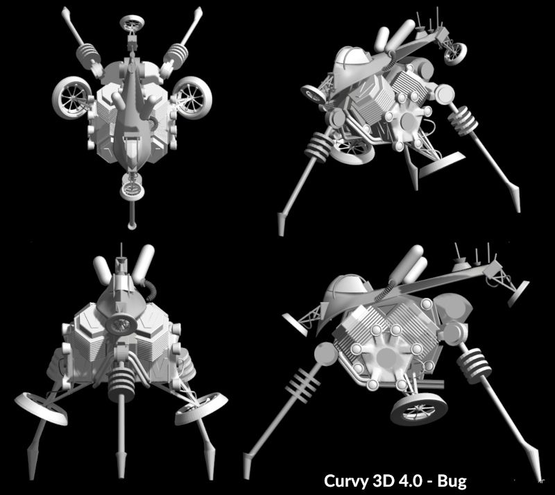

Sci-fi Vehicle modelled in Curvy, rendered in Blender.

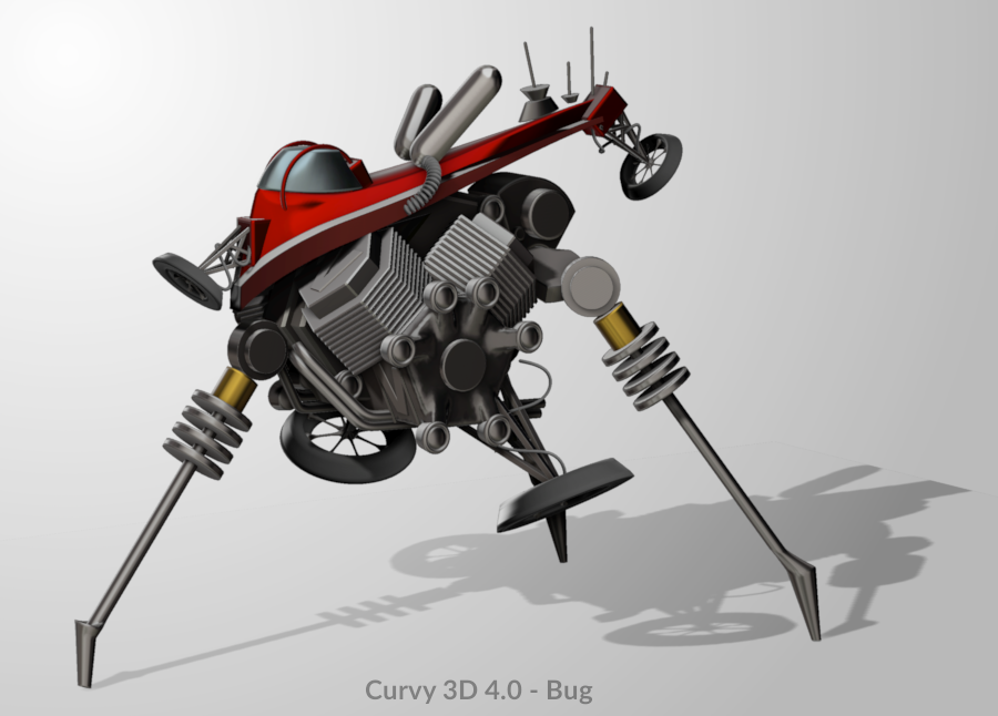

Vehicle in Curvy's own renderer.
Clay shading of Vehicle.

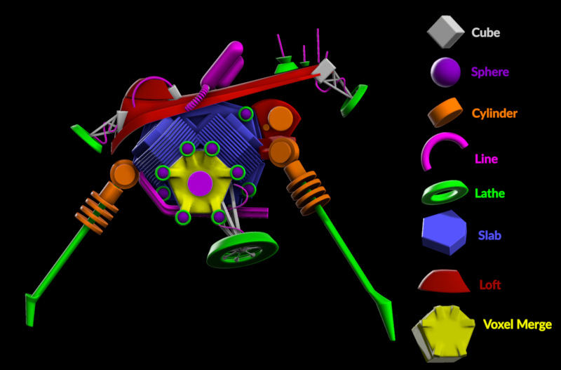

This image shows how the model was constructed from different Curvy primitive types.

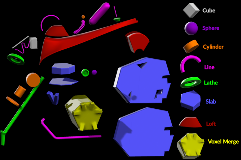

Splitting up the mesh and removing copies of the same object shows a simpler view of the parts required.

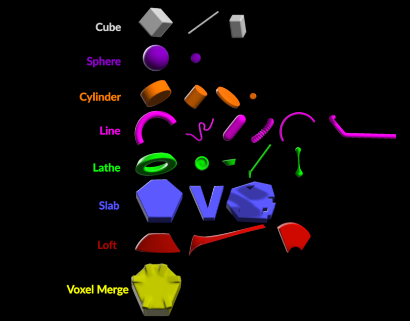

Here are the individual parts listed by type:

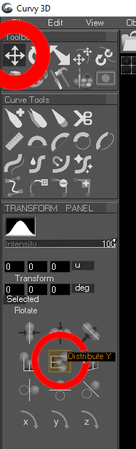

Sorry it went a bit fast, here is the location of the Distribute button, select any transform tool, like move, and use the buttons below in the sidebar.
