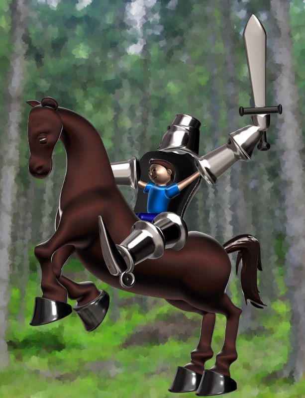

Unicorn is definitely doable in Curvy, the hardest part is a good knowledge of anatomy (which sadly I don't have). Here are a few examples I have made...
The main trick is to load your image as a backdrop and trace several shapes as overlapping Lathes - eg: One for each leg, body, head. Then you can use a Curvy Map to sculpt them a bit - if you keep them as Lathes they will export cleanly as Sculpties. (Using Mesh editing will make them much harder to export as Sculpties as the UVs get mucked up).
