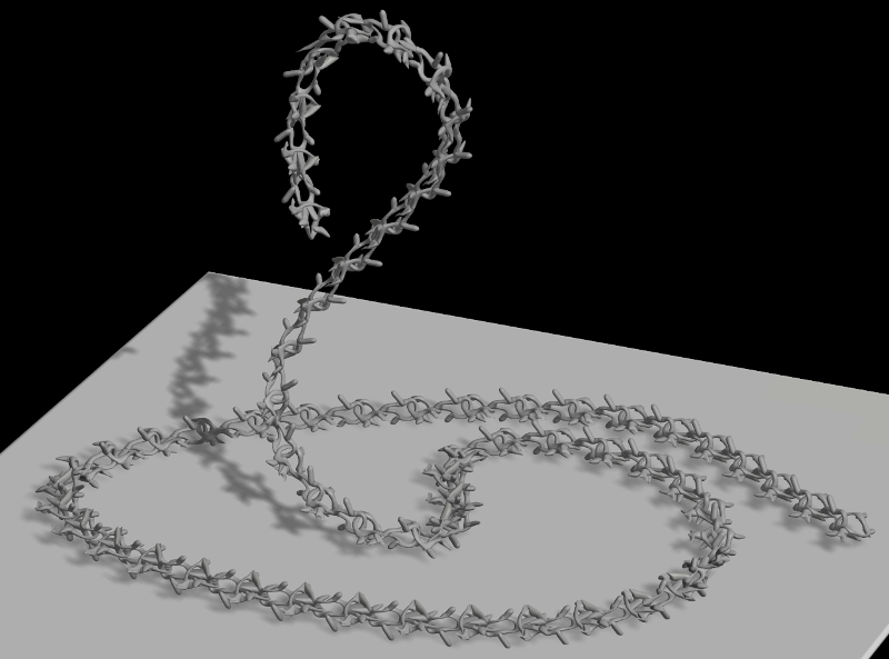

This is the simplest warp so far - Just draw two curves and the mesh will warp from the first to the second.
Perfect for long swishing shapes like this chain (To be honest I've wanted this feature for years!)
