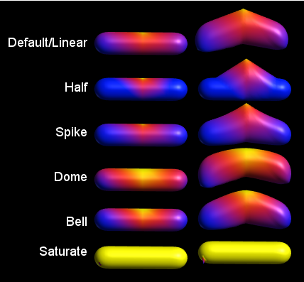

8.6. Shapes
The "Mask by Distance" tool gives a linear falloff. By changing the contrast and distribution of the mask other shape falloffs are possible.
Half
Re-Masks only the top 50% of the original mask.
Spike
Darkens to the mask resulting in a sharp point falloff curve.
Dome
Brightens the mask producing a hemisphere shape falloff.
Bell
Adds contrast to the mask, resunting in a bell shaped falloff.
Saturate
Turns any part of the mesh even slightly masked to a full masked version. useful for turning a soft mask into a sharp edged one.

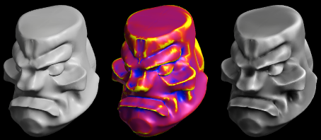

8.7. Mask by Curvature
Sets mask value from the shape of the surface, with the sharpest spikes and creases most selected, and the deepest pits and sharpest crevaces left unmasked.
Above shown with "Surface/Mask->Colour" on the right.

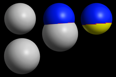

8.8. Mask Interior
Masks parts of the mesh that lie inside other parts - overlapping parts of the mesh.
This is useful for cutting up meshes.
8.9. Mask From Children
Masks the part of a mesh that lies inside a child of that mesh.
Again, useful for clipping bits of a mesh ready for Stitching.

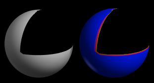

8.10. Mask Boundary
Masks edges of a mesh. Typically masks a loop around any holes in the mesh.
This can be helpful in detecting holes in the mesh.
