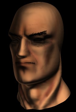

Here is an object with a black highlight colour - it looks soft and dull.

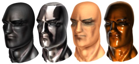

Below are images of the same model with different lightmaps and colours:
